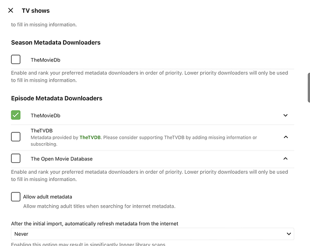

You may consider switching the metadata provider used in Emby for TV shows to TMDB (this option can be found when using the Edit option for the Emby library). This would include the necessary info for Infuse to match these to titles on OpenSubtitles.
You can then use the Refresh Metadata option to update the info for the items in your library.

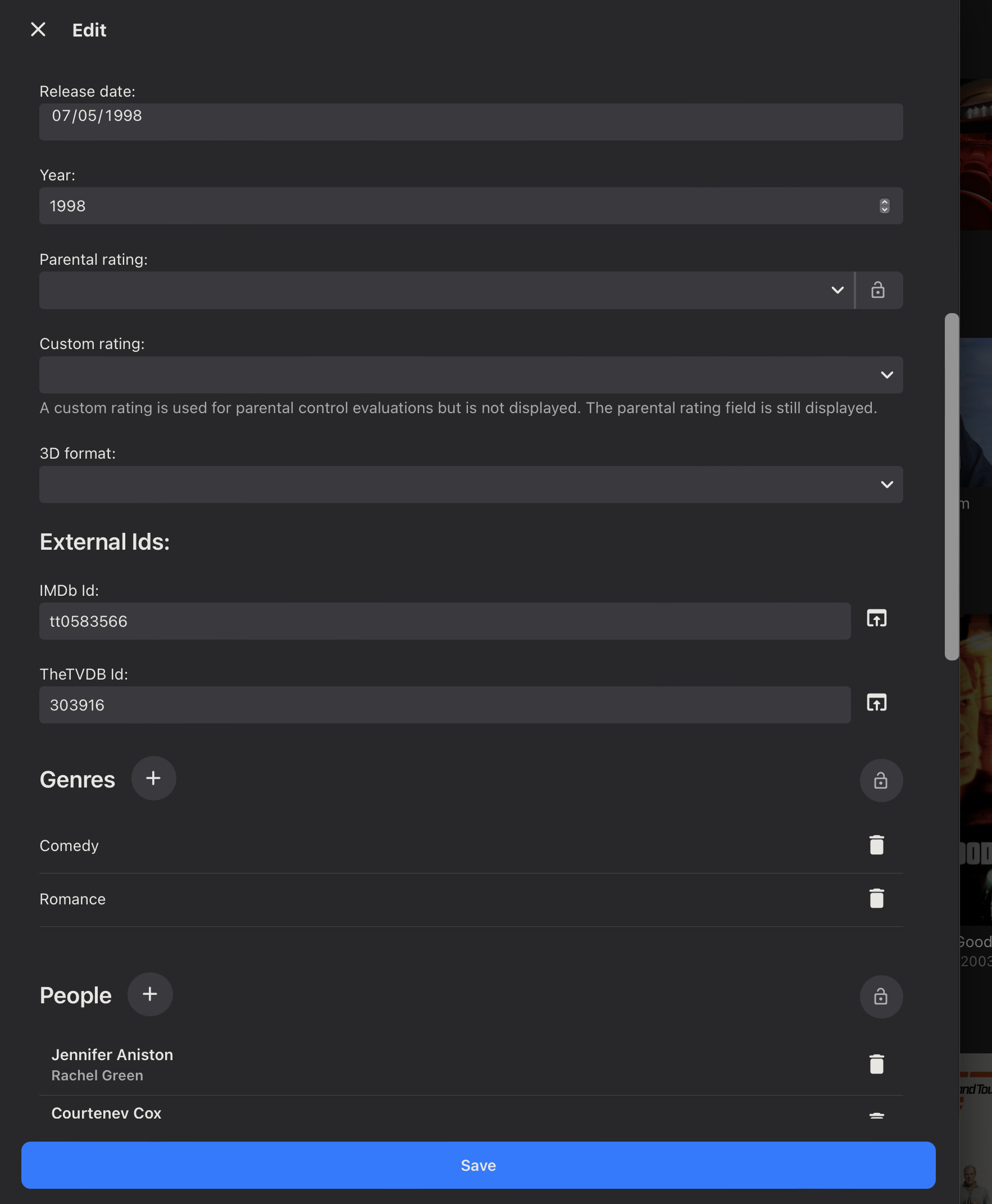

Series have in Emby the correct IMDB ID - tt0583566 and TVDB ID - 303916
I think though that that may actually be a problem, as an opensubtitles search by that (correct) IMDB, returns… nothing?!?
I tried some other random series, like IMDB ID tt0551427 (Curb S01E06) - again nothing in Opensubtitles
