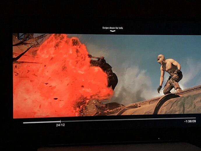

iā€™ve a terrible color problem with fire and explosions on some movies, look at the attachments, this is MAD MAX 2160P HDR MKV (the one with the time mark is apple tv 4k + infuse) the other one is the same file playing directly from USB

iā€™m using infuse 5.6.1, also this not happen if i play the movie on the USB player, or with itunes purchases
apple tv is set to 4K HDR 4:2:2 (also try 4:2:0 and SDR but infuse keeps showing red fire)
my tv is a samsung ju6500, all post processing and ā€œenhanced colorā€ features are turned off

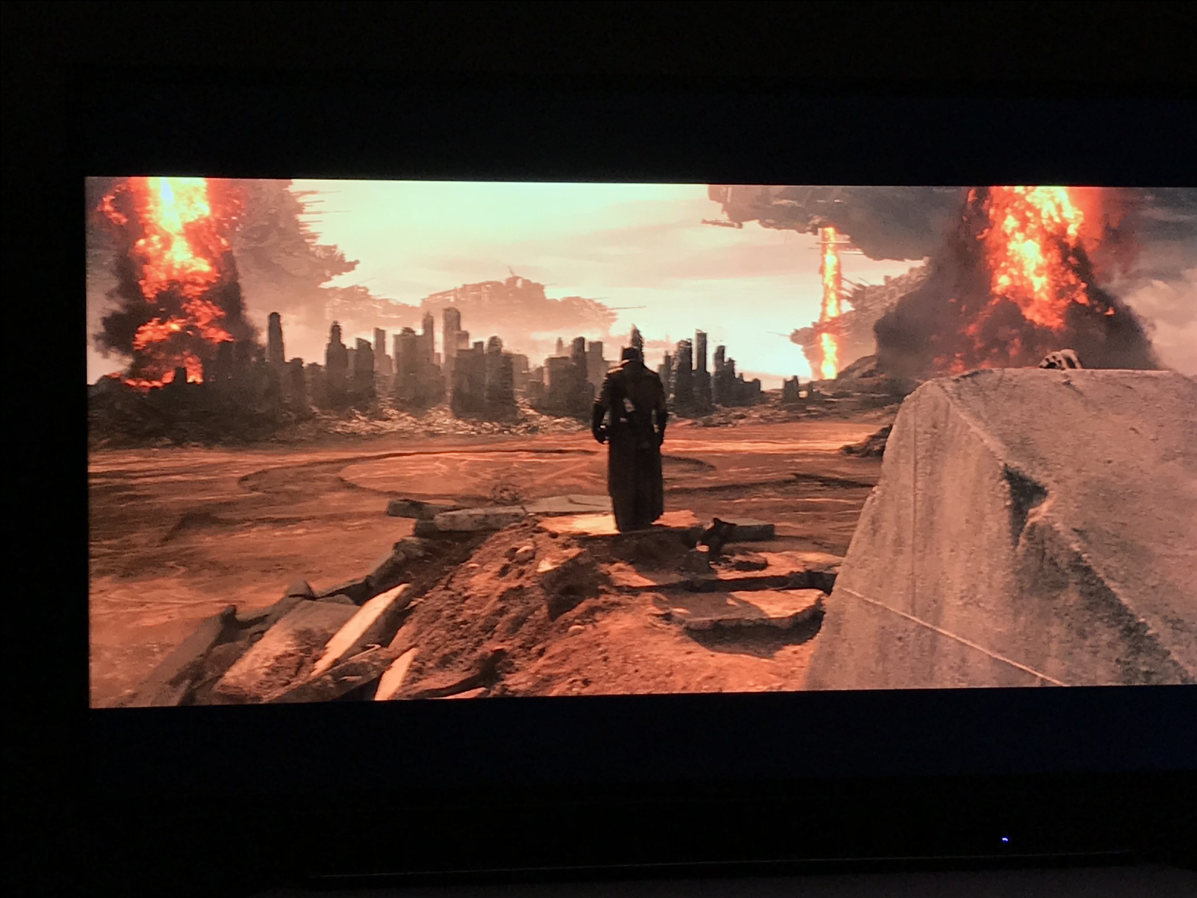

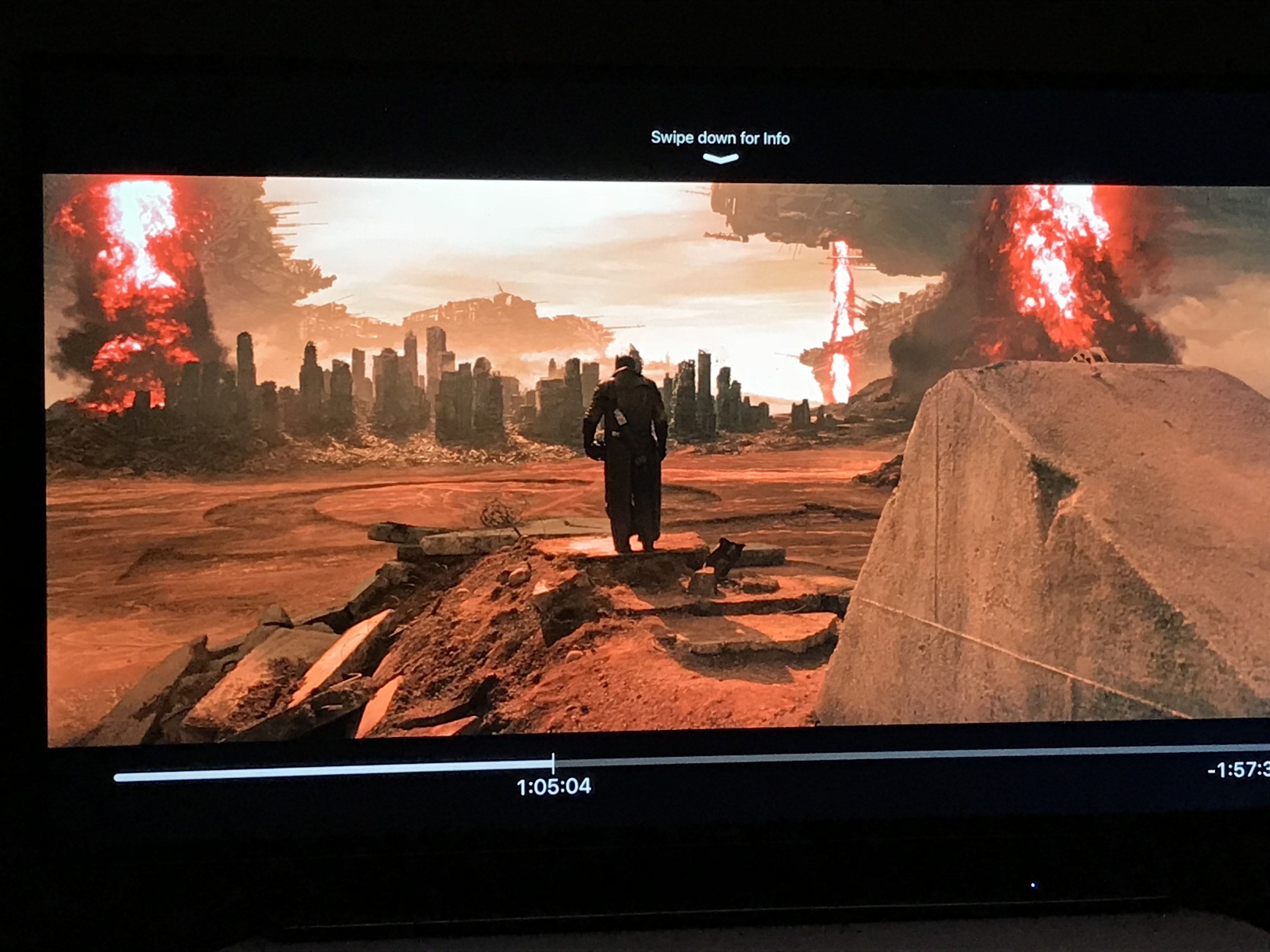

this is a infuse color reading issue iā€™ve more screenshots for you to see, look at batman v superman mkv

I have this same movie, so I tested it out (I only have Mad Max in 1080p so I canā€™t test that for you). Itā€™s not an Infuse color issue, itā€™s what the colors on the 4K disc actually are (where the fire looks more like lava). I just tested this out 4 different ways:
Infuse with 4K HDR UHD rip BvS - Looks like yours does
iTunes with 4K HDR BvS - Looks like Infuse
Xbox One S with 4K HDR UHD disc BvS - Looks like Infuse
Xbox One S with disc 1080p BvS - Looks like your BluRay picture.
iā€™m sorry man, but this only happens on infuse, the same files on USB fire looks yellow and not so RED like the screenshots (both with HDR)
iā€™m starting to think you are not reading my post, file plays fine on USB! with HDR and amazing colors, only on infuse i can see red fire way over saturated like the screenshots
