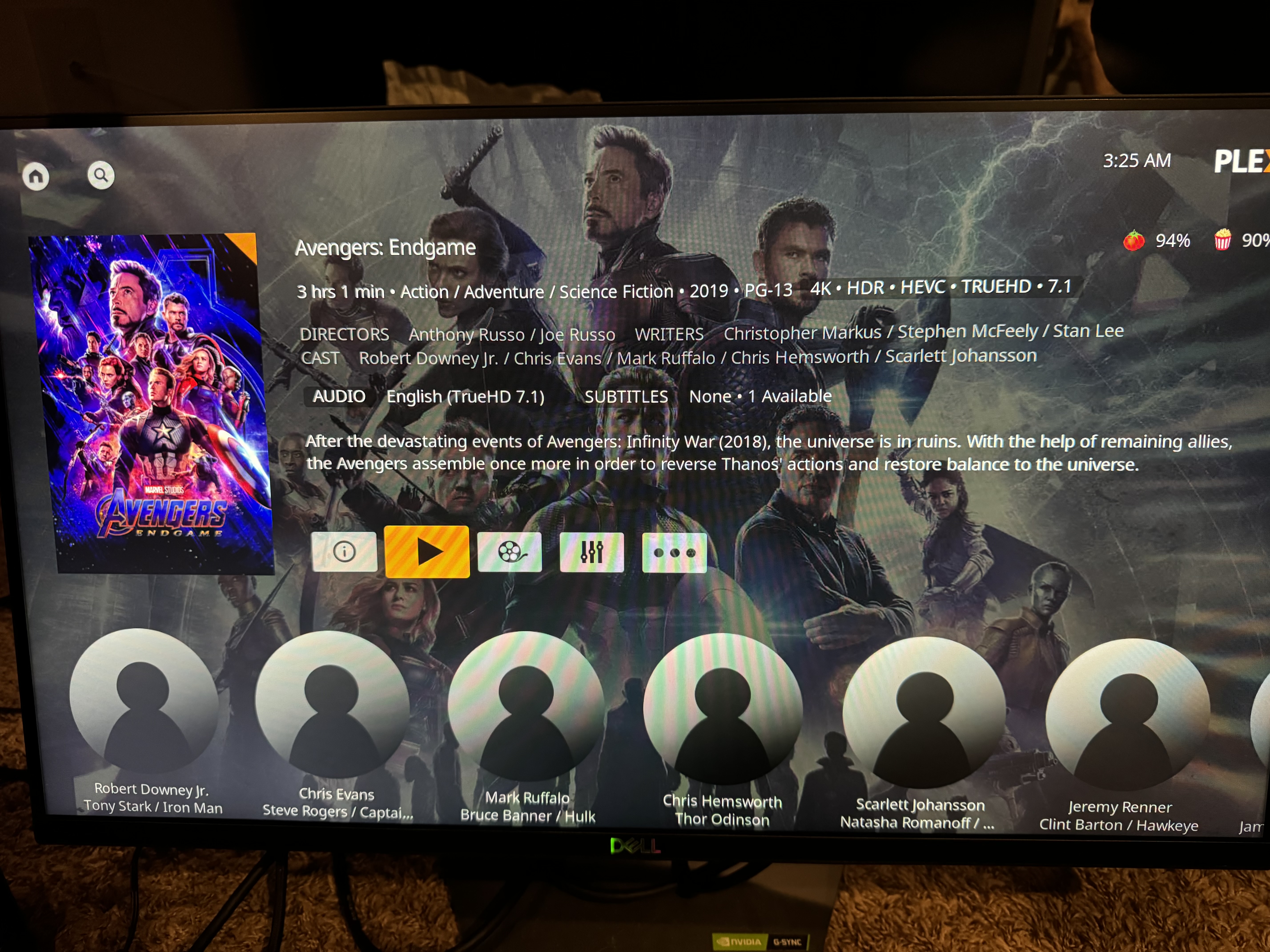

I just ordered one. I understand you can run the Plex mod which basically gives you a Plex UI and library with the Kodi player, which would be decent, but I can’t find any recent videos or screenshots of it.
I just got mine in the mail so I can install this and take a couple of screenshots and post them here so you can see what it looks like.
Okay here you go just finished doing it here is the interface screenshots. I’ve included the Home Screen along with media library and movie info screen.
Edit: for now it seems there is an issue with this add on not playing FEL correctly where Kodi plays it fine so tell they fix this issue I wouldn’t recommend this for FEL playback.
Ok! Not bad at all! Still probably not quite as nice as Infuse I’m guessing, but still not bad. Looking forward to getting mine and playing with it!

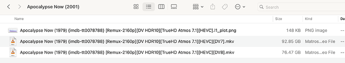

In case anyone else is trying to figure out how to set up their libraries to account for DV7/DV8 files, here’s what I’ve been doing…
For many movies, with FEL layers, I leave both a [DV7] and [DV8] file in the movie’s folder

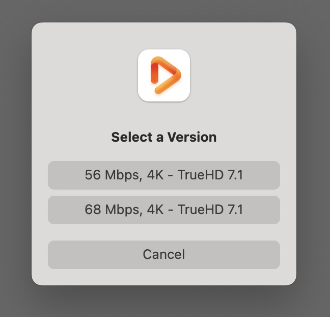

When playing in Infuse, you get an obvious choice:

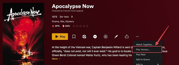

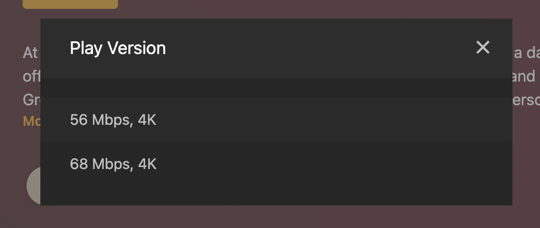

When playing in PM4K, which will hopefully work soon on the Ugoos, it should behave like Plex – which is the same but with an extra step to “Play Version”:
