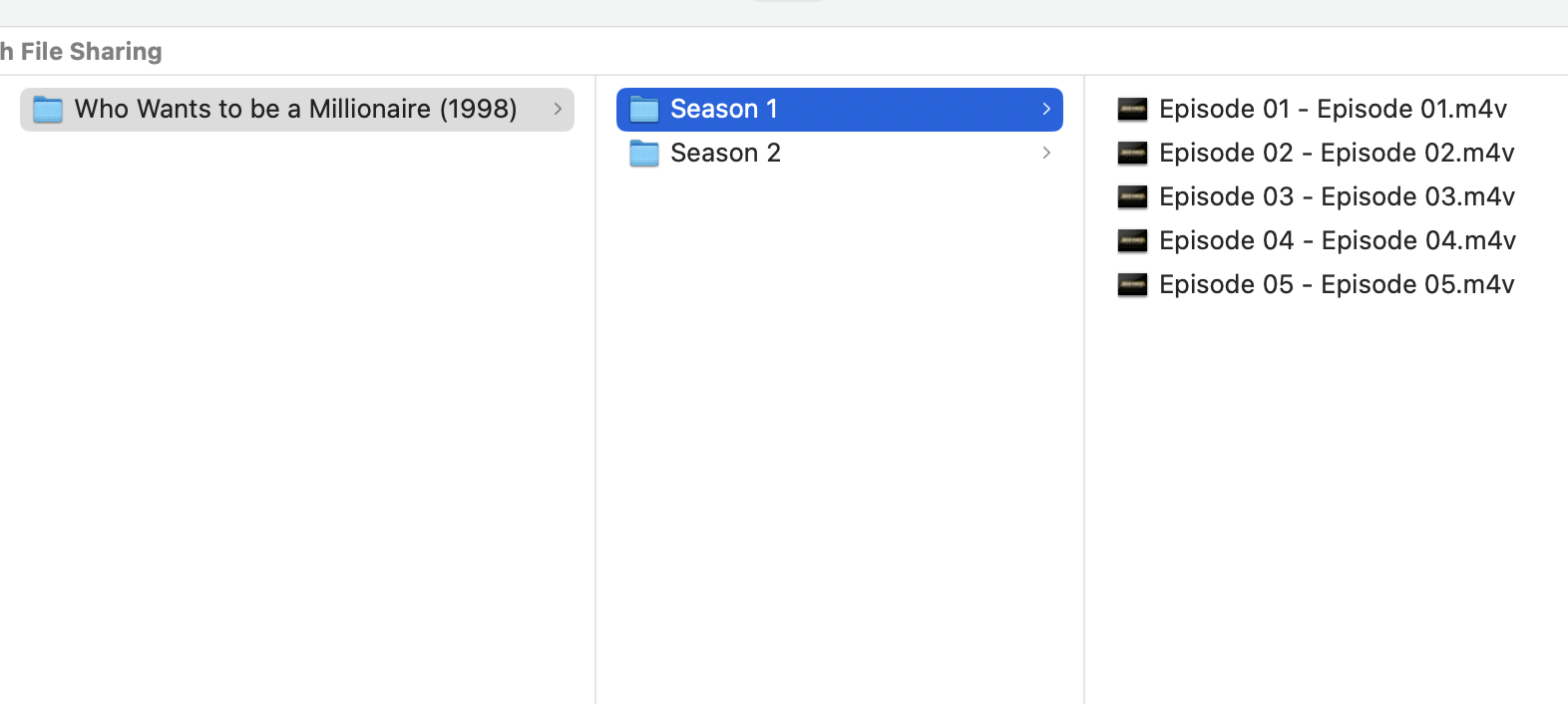

Hi there. I have been using Infuse for a while on my iPad and love the app for playing back my local archive of TV Shows. However, I struggle quite a bit with getting it to behave in regards of metadata, and wonder if the community can help.
To my understanding of the documentation, if I set up a folder structure like the below image, I should be able to get Infuse to query themoviedb.org and detect the required metadata from their database:
However, despite the structure of the folders matching a known format, no matter what I do, Infuse is obsessed in trying to make this file match completely random movies, and almost always fails to detect this as being a TV Show. The only format that I’ve found which seems to work (and which goes against the defined support article) is to write the file names as “NameOfTheShow S00E00.m4v” (where the 00 represent the appropriate season and episode numbers), but this looks daft when I’ve put the files in a folder structure that should clearly identify what episode/tv show I’m looking for.
This also leads me to have hubris with the search box for “metadata editing” if I wanted to manually define it: the search feature repeatedly only searches for movies. Even if I type “The Crystal Maze” (using the example above in the image), Infuse constantly says “no search results”, which is frustrating.
If someone could tell me how to search to make it detect a TV Show, that would be helpful, as well as guidance on where I’m going wrong on naming the files. I have tried alternative formats suggested by the support article (eg 1-01 Episode 01.m4v or 01 Episode 01.m4v, but neither of these work).
NB: It’s worth pointing out that the files are designed to be played on a multitude of devices, many of which don’t have Infuse installed on them, meaning that trying to make the files fit Infuse on a single iPad is cumbersome when that format isn’t needed on those devices that just connect to the media server directly without Infuse.

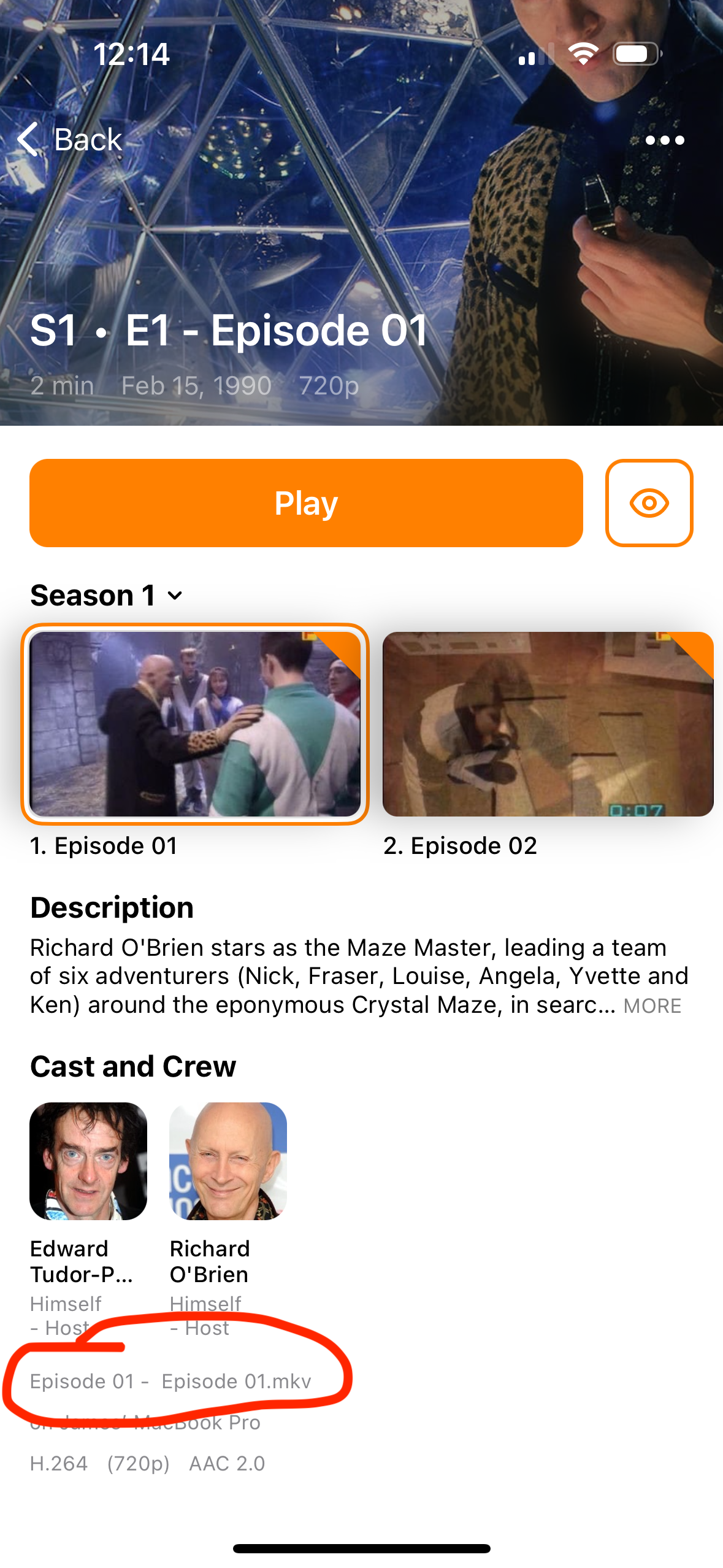

Hi there, thanks for the quick reply (and approval of the OP).
I have tried this format as well, but Infuse still thinks that my file is Episode 01 from a documentary called “INTO OBLIVION” released in 2022, and not an episode of the Crystal Maze from 1990. Episodes of the Crystal Maze don’t have real names, its just “Episode XX” (where XX is the episode number in two-digit format), so this means the file name is Episode 01 - Episode 01.m4v.
Using “Edit Metadata” and searching the shows’ name does nothing, as I only get “no results found”.
I can use the format of doing The Crystal Maze S01E01.m4v which picks up the metadata correctly (variations of that format were the only ones that worked), but naturally naming files like that seems a bit counter-intuitive and also, that naming convention is obviously meant for situations where you create one folder and dump hundreds of files into the folder, with no organisation done on the file system.
FWIW, the same problem impacts the UK version of Who Wants to be a Millionaire: notably that its title on TMDB includes a question mark (which is forbidden in folder names on Windows) and the titles are just “Episode XX”, meaning those won’t be detected either (although Infuse seems to think that the files I have for that show belong to One Piece, despite having nothing to do with it lol)

Thanks for looking, thats honestly very strange!! I have used the same format but I’m only getting the aforementioned “INTO OBLIVION” documentary. The only differences I’m seeing is that your file is an mkv and has a double space after the hyphen, whereas my file is an m4v and contains no double space. Surely the use of an M4V wouldn’t cause Infuse to struggle with identifying the file correctly?

Not sure how I will be able to fix the issue with “Who Wants to be a Millionaire” though, as the TMDB entry includes question marks that are not possible to set on the folder name locally, and I’m unable to manually assign the metadata to bypass this issue.
